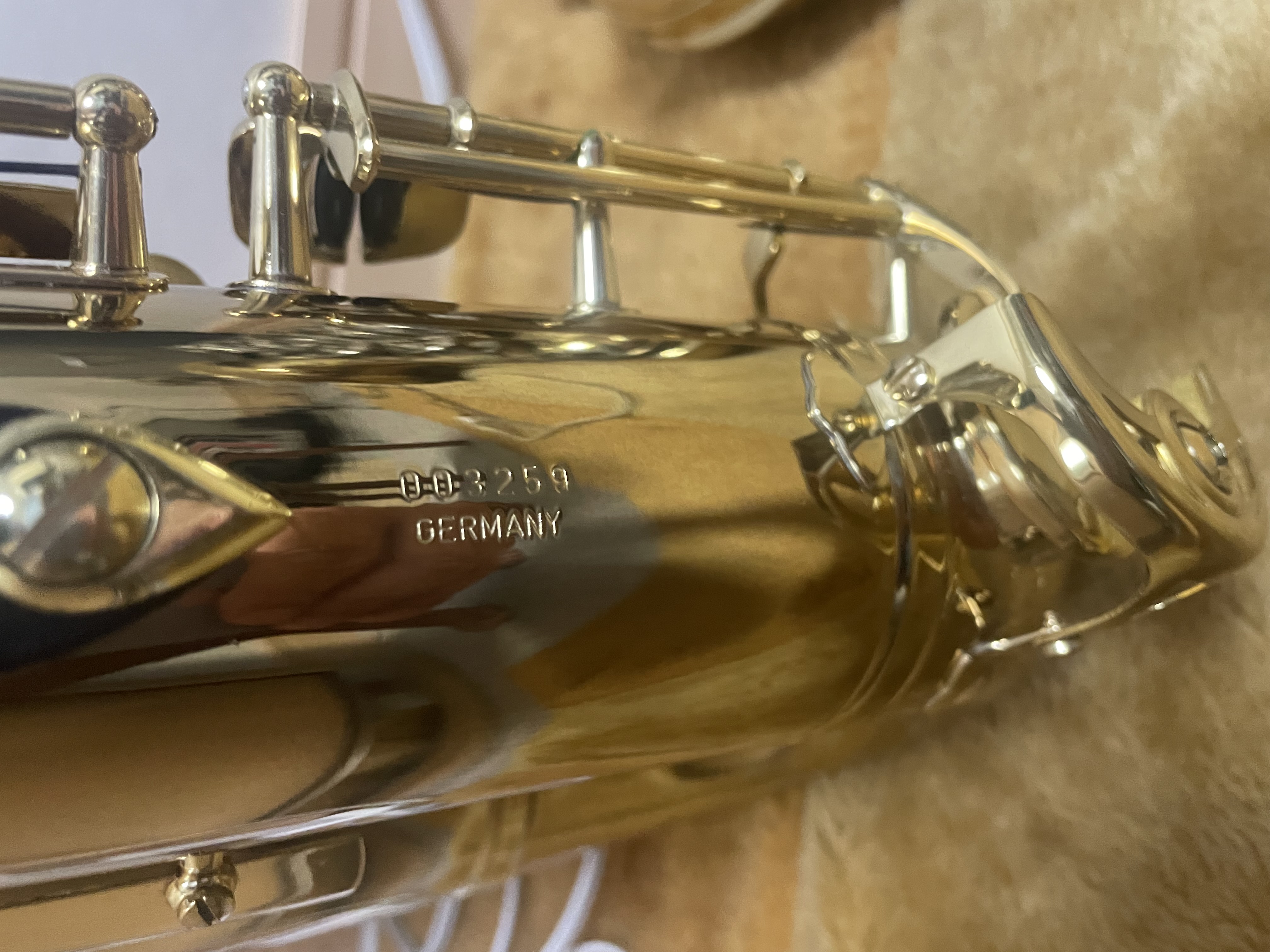

Can somebody tell me about this blue label tenor made by B&S for Kawai ? The neck, bow and bell seems different than the early blue labels.

You are absolutely right - this is not a "standard" Blue Label horn.
It was made after the German Re-Union.
In order to give you more details, I would like to see additional photos showing the full saxophone, one from each side.
Could be model Series 1000, Series 2001 or even Dave Guardala etc.
Let's see.
Regards, Tobi.

The keys looks same as the earlier blue label with ribbed construction. The bell and bow has a narrower bore than the earlier blue labels. And the neck has a different taper.
It plays nice with a more modern feel than the original blue labels.
Looking forward to know more about this horn.
Ok, now it's clear.
The "Blue Label" saxophones were two models, an early and a late one. Your Kawai Tenor is the Late Model.
This line was built from 1985 to ~1994, which should be the manufacturing year for your Tenor.
Compare the following pics - both show late models. The only difference for me is the missing key protection for CIS.
And maybe the shape/contour of left and right pinky tables.
Hope that this was what you were looking for.
Regards, Tobi
