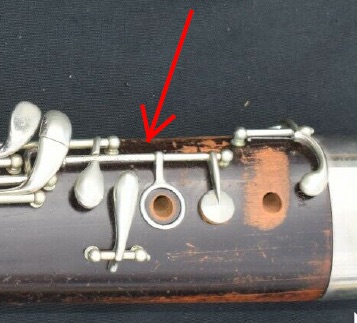

dear colleagues, I just came across this discussion concerning the DRGM-Nummer 301669. I recently acquired a bassoon with the label "Carl Fischer" of New York. The DRGM # is stamped on the rod connected to a ring on the second hole on the boot joint (see photo). Would this indicate that the bassoon had been made at the Adler factory, then exported to the USA under the Carl Fischer label?

kevin hat geschrieben:dear colleagues, I just came across this discussion concerning the DRGM-Nummer 301669. I recently acquired a bassoon with the label "Carl Fischer" of New York. The DRGM # is stamped on the rod connected to a ring on the second hole on the boot joint (see photo). Would this indicate that the bassoon had been made at the Adler factory, then exported to the USA under the Carl Fischer label?
thanks and best wishes
Kevin Tuite

Oh yes I am convinced this is an Adler bassoon. I have found an instrument in the Leipzig museum that has similar key work and that one is also stamped ADLER in a cartouche. Also, other details are the same. I have also proof for a relation between Adler and Carl Fischer. There is a bassoon marked with both names. I still intend to do a paper for IDRS on this subject, probaly next year.
Probably, you can find a serial number on the "rim" of the boot cap.
