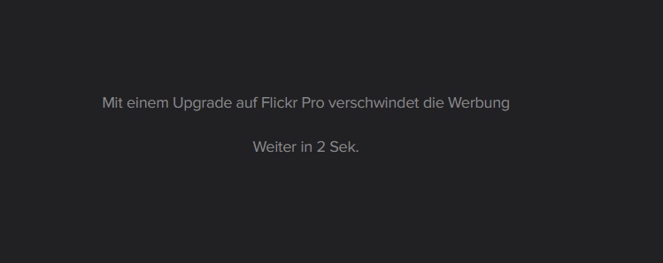

Initial comment: You are able to put bic pics directly into the threads of this forum.
The links you provided always lead to comments like this:
This disturbes the flow and is kind of frustrating while comparing pictures. If you want further input, you should show your photos directly here. And please use focussed pics, yours are not good quality.
